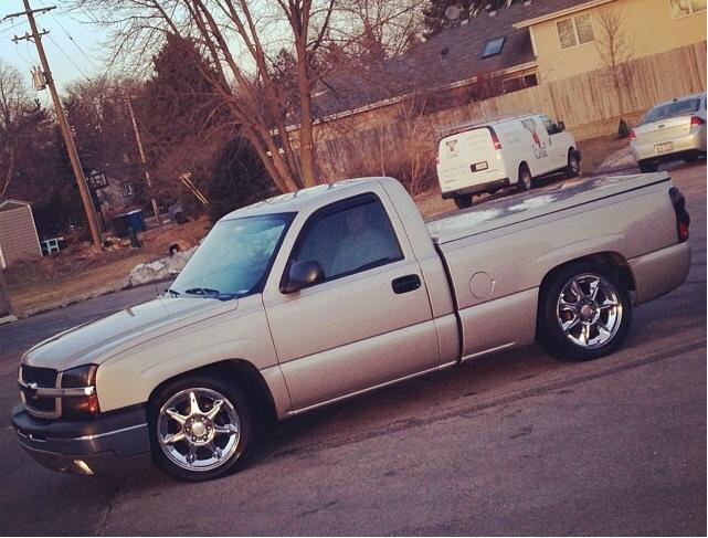

This is the way its sitting right now picked up some Torq Thrust 2's for it but have not got them installed
