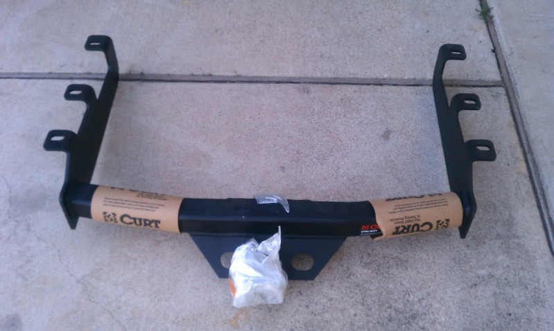

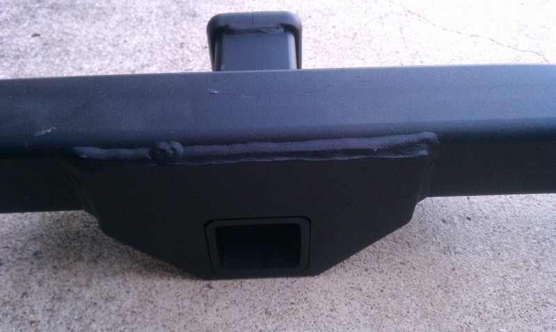

How it comes out of the box
Beefy

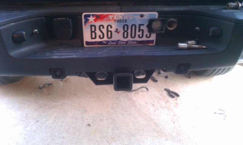

The stock hitch, notice how it hangs down about two inches below the bumper.

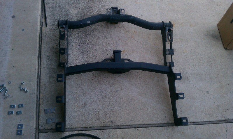

Comaprison of the stocker vs the curt. Physically it doesnt look like that big of a difference but the difference in gauge of the steel is huge. The curt hitch weighs atleast double what the stocker does as I verified when it fell on my knee while positioning it

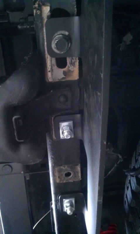

The Curt hitch bolted up. It reuses the two holes closest to the bumper but uses an existing hole further towards the axle and not the hole the factory hitch used as you can see by the under coat missing. Some things to note, all the factory bolts are 21mm and the supplied hardware with the Curt hitch is 19mm.

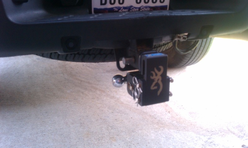

Installed, notice the reciever tube is now tucked up nice and close to the bumper

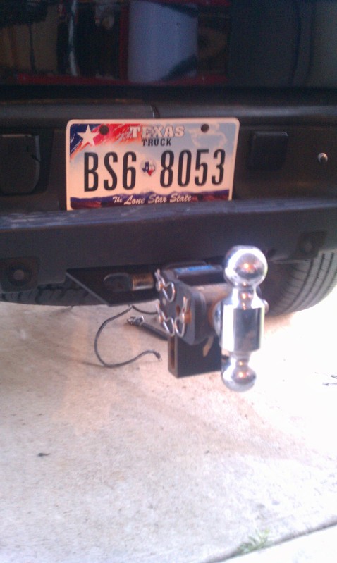

With my B&W tow and stow installed back in
Besides the shear strength gained by going with this hitch, I really like that it moves the ball mount up two inches. That will helpw ith offroad departure angles at the deer lease and will also help keep the trailer level with heavy loads. In the past when Ive towed a heavy tongue weight trailer Ive had to flip my drop hitch to a raise hitch but now with the gained two inches I shouldnt have to. Along with the airlift helper bags I recently installed should help with that too but Ill make a separate thread for that.
This hitch from my research is the best deal out there for a tough aftermarket hitch. Most of the other class V hitches have the main cross tube hanging below the bumper and/or the reciever tube at the stock height. This one is hidden like the stocker and also raises the receiver tube up, win win IMO.
Beefy
