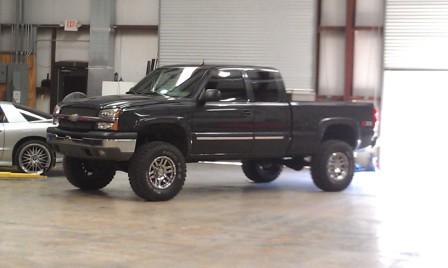

The NTD kit use's a spindle for some of the lift. It is suppose to keep the ride less rigid. I had to use F150 keys to get mine to clear the 35's. I also had to re arch and add a leaf to the rear. The NTD kit is nice but I didn't get the 6 inches out of the lift. When I got it to clear the tiers the front axles made noise and I had to back off some That was with the spacer also. The ride on the NTD kit was sponge but now it rides good but stiffer with the keys.
