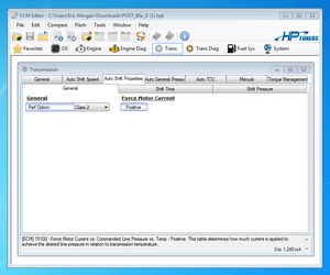

under trans "Auto shift properties" under "general" tab.
I don't even like HP tuners lay out and I still found it fast...

Sorry boss. I'm in advanced view and this is all I get. Latest version 3.xx. Tune attached.
