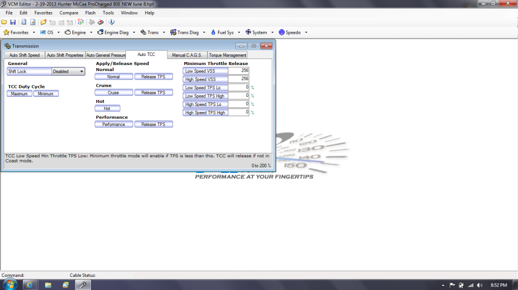

Change your minimum throttle release tables to match these. Lemme know.

I made the changes and its still doing it. If I drive I, itt seems to go and then converter unlocks or locks not sure and I cant drive at high way speeds motor just revs. I have to slow down tell I believe tell it gets back it gets back first gear.

That almost sounds like your transmission is slipping, not a converter lock/unlock issue. Have you checked your fluid? Pulled the pan? What does it look like?
